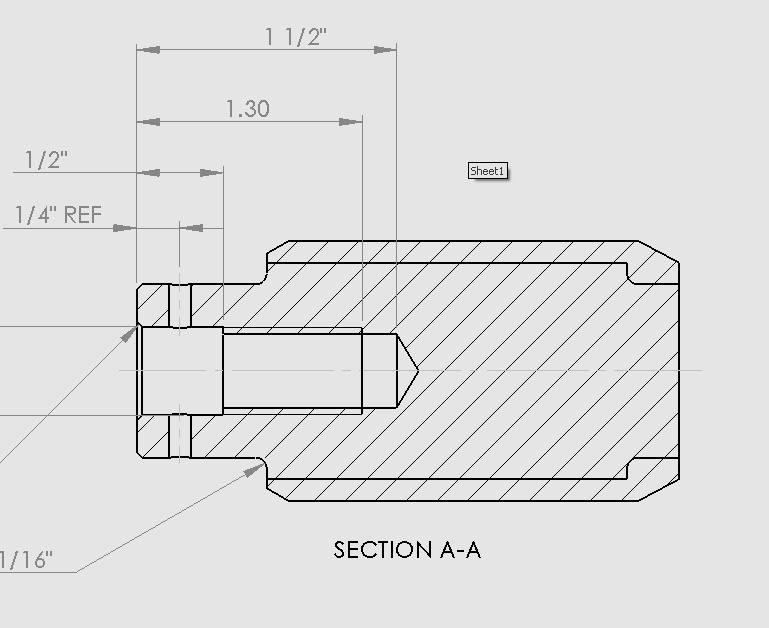

However, for the weld drg I hatch feature 2 differently to show where the weld is, for the finish machine drawing I am unable to hide all the lines between the 2 bodies so wanted to have a way of turning off and on the merge bodies function depending on the configuration.
The attached shows the finished machine drg. When I try and hide the offending lines I need to do it twice, once I assume for each body. If I click the horizontal lines in different places I can sometimes get the hide line question to appear but for the vertical lines this question never appears twice.
Ideally I would merge the features for finish machine and unmerge for Weld configuration. Is this an option?
