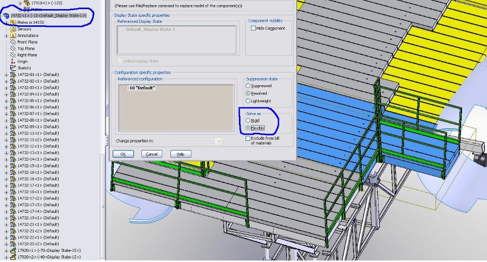

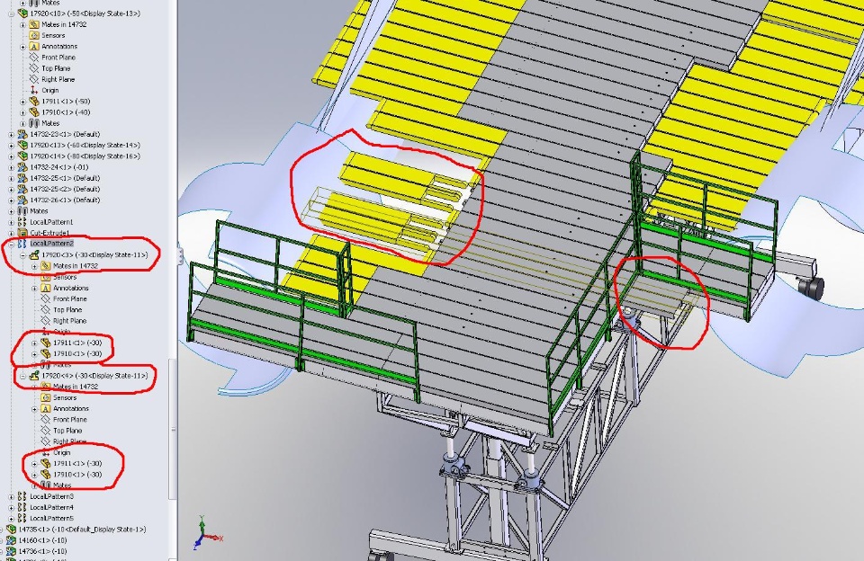

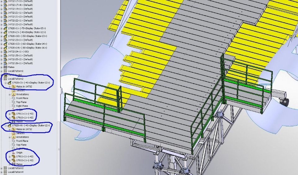

This is the second time I've posted this problem. This time Ihave some new examples (see attahced jpegs):
I have a 'stand' assembly. Within it are seperate 'module'sub-assemblies. These sub-assemblies contain 'sliding deck'sub-assemblies which are different configurations for differentlengths.
When I am in the 'stand' assembly and I switch a 'modulesub-assembly' to 'flexible', some of the 'sliding deck'sub-assemblies change on there own!
I've noticed that it (in this case) seems to only be switchingconfigs on sub-assemblies that are part of a local pattern.
Is this operator error? Please help...
Thanks,
BrandonSolidworksAssemblies
