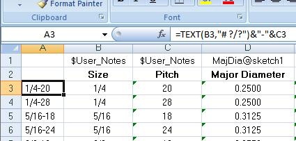

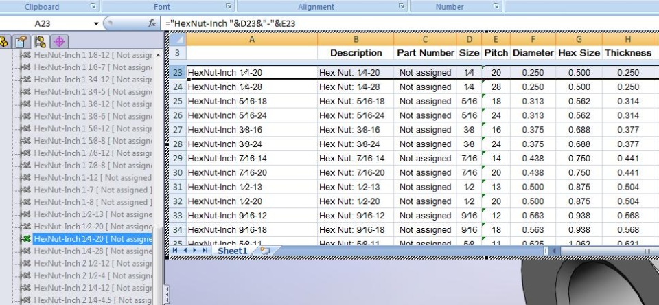

I'm trying to get configuration names with fractions to workand can't seem to get it. I found a post(here)that gives some info on how to do it using the TEXT function. I'vegot the function working in my spreadsheet but when I import andthen exit from the design table in SW I get no configurations butall the data stays in teh table. Is this not really possible or amI messing something up?
Screen shot below shows the formula I'm using.SolidworksConfigurations design Tables
