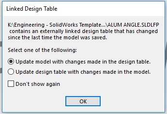

Hi all.  For some of our weldment profiles we have configured library features that are driven by externally linked design tables.  This has all been working fine for years.  Now (seemingly just happened with 2020 upgrade) - whenever a weldment is edited in the part level, Solidworks will open all of the profile library features (the configurable ones at least).  I am the only one with write access to these but it's rather annoying to have them all open.
If I open the feature straight I get this message (this pops up sometimes when editing the weldment as well) -
No matter which option I select, if I save the profile and close - the same message will come up next time I open it.
Any advice?
