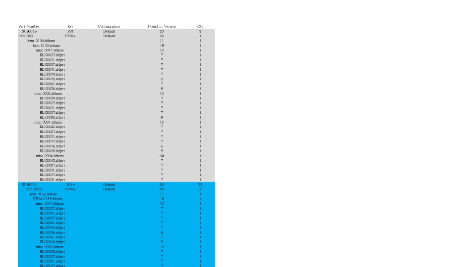

See attached Excel sheet.
I have an assembly that has (3) subassembly's that all call for Item 0053.  The spreadsheet is the export BOM in excel, the 3 subs are color coded, notice in the Configuration, and Found In Version columns all the values are the same.
The problem is the Quantities in 2 of the subs are the "as built" quantities or just "1". The other sub shows the correct quantities.
Item 0053 has a BOM of virtual components that were copied and pasted.
I can't figure out why all 3 sub assemblies don't display the correct quantities.
Any ideas?
