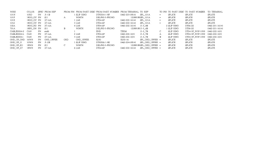

When I import the Excel spreadsheet with the routing information, some of the components and splices don't come in correctly.  Some splices come in as components (ready to place) and some components are shown as splices (need to be added later).  I did find a help file discussion about using * for the splice pin number to have it added in later.  This has occurred on 2 different spreadsheets and new assemblies.  Attached is one of the files.
