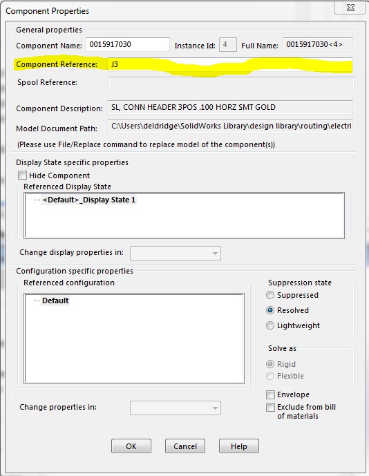

In an assembly, you can set the Component Reference for each part.
See 2016 SOLIDWORKS Help - Component Properties Dialog Box
How can I move, copy or dissolve components with "Component Reference" to another assembly while maintaining the "Component Reference" Tag to be used in drawings?

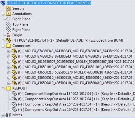

PCB/Restriction Drawing Level

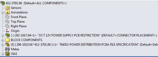

Assembled Board Level:

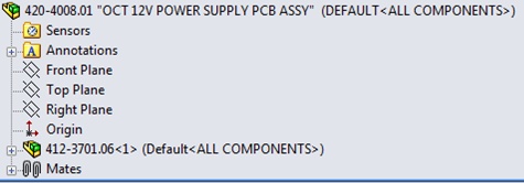

If mechanical features such as heat sinks are added, one more assy level:
