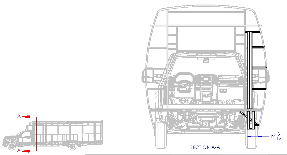

I have the component line font changed to make this part and its location inside the assembly stand out. Whenever I use print, or save to a PDF the line font changes back to the lighter "ghost" layer. This also happens if I close and re-open a drawing. I cannot for the life of me get the lines for this component stay black. Is there something I'm missing?
I'm right clicking the component in the feature tree and selecting "component line font..." then deselecting default and selecting from selection and picking the "0" layer. I never select the assembly and turn it to "ghost" rather I select each sub-part and turn them each individually hoping that the "ghost" setting on the assembly level doesn't override the individual components. I like this feature but its proving to be useless past the original drawing file and even then only until the drawing is closed.
