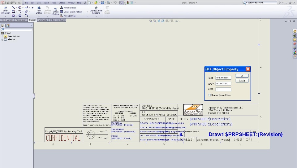

6. From the forums I got the idea to copy the image in an image editor, and paste it into SolidWorks. The 2400 DPI bitmap (3/4" tall) basically crashed SolidWorks; slowed it to a halt. The 300 DPI file was no problem, except on the screen it's just a white rectangle (pastes fine into Word). It does not print pixelated, which is nice, but the proportions are wrong. If you try to edit the dimensions through the bitmap object's properties, it's no good because it's fixed on the wrong proportions. You can size it by hand on the screen but since all you see is a white rectangle your only feedback is printing.... Maybe you could get away with taping a ruler to your monitor and getting the proportions right.
