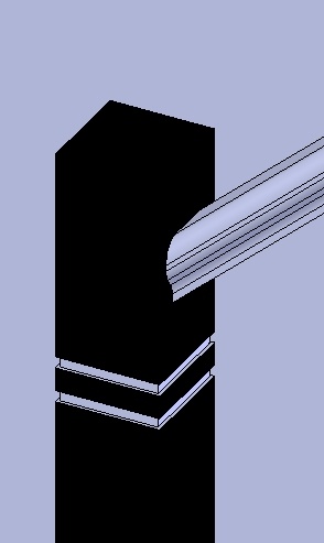

Hi There,
I am trying to alter the colour of a feature (Boss-Extrude) to a light brown colour using a VBA macro. However when the macro runs the feature that has been selected turns black.
Now, when I go into the appearance properties the colour shows as light brown but in the graphics window it is black.
Also if I close the part and assembly and re-open them the colour has changed to the light brown.
I don’t want to have to close and re-open the documents.
Any suggestions?
Thanks
Dec
Here is the code:

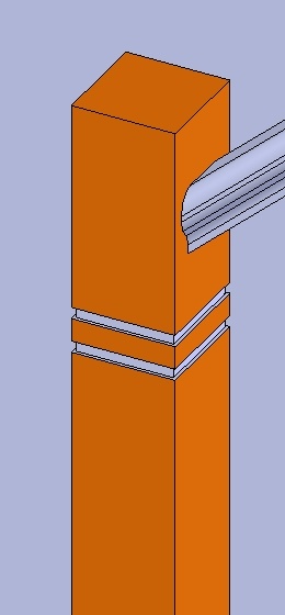

    BEFORE

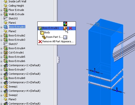

SHOWING BROWN IN APPEARANCE WINDOW
I HAVE CLOSED THE PART AND ASSEMBLY DOWN. RE-OPENED THEM AND THE FEATURE IS NOW BROWN
