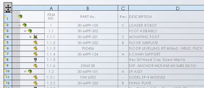

For each project I usually produce an indented BOM for the main assembly, that is a layout drawing of a machine. Then I copy the BOM to excel in order to produce a BOM document to be given to the customer.

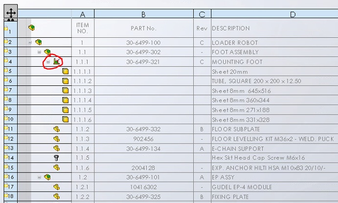

In the indented BOM I get also each weldement-type part exploded to single items.
The end customer looks at BOM for spare parts and they obviously don't need single weldement items; they rather get confused.
Therefore I currently collapse each weldement-type part manually in the BOM by clicking on the 'minus' icon
obtaining this:
In a large assembly this operation is time consuming and there is the possibility to likely miss some part.
