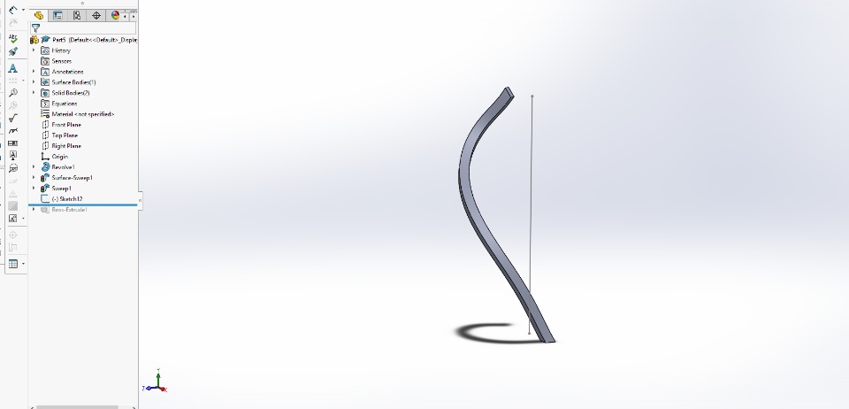

So, ive:

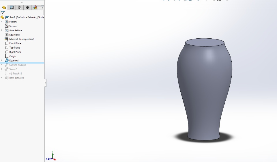

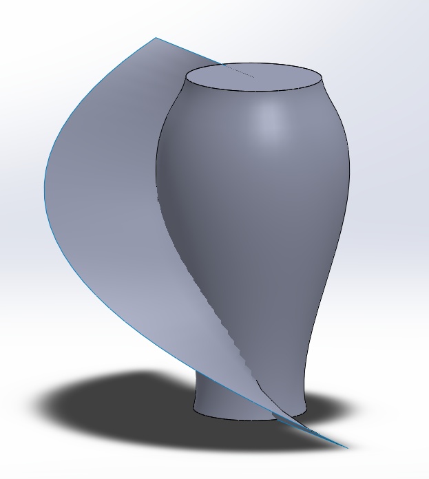

1) created revolved body as my base

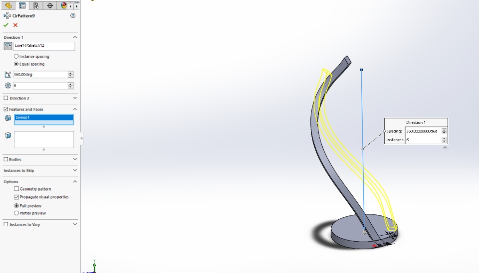

2) created sweeping surface of a lane to create an intersection curve of the shape I want.

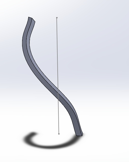

3) used 'intersection curve' to create a line of the curve I want
4) hid the parts from step 1 and 2 to be left with my curved line in 3D space
5) created a swept body to create my first piece

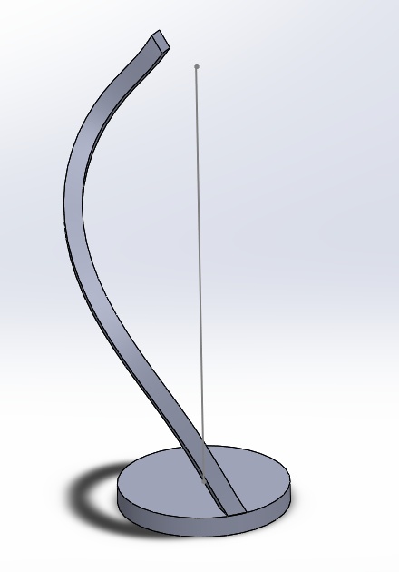

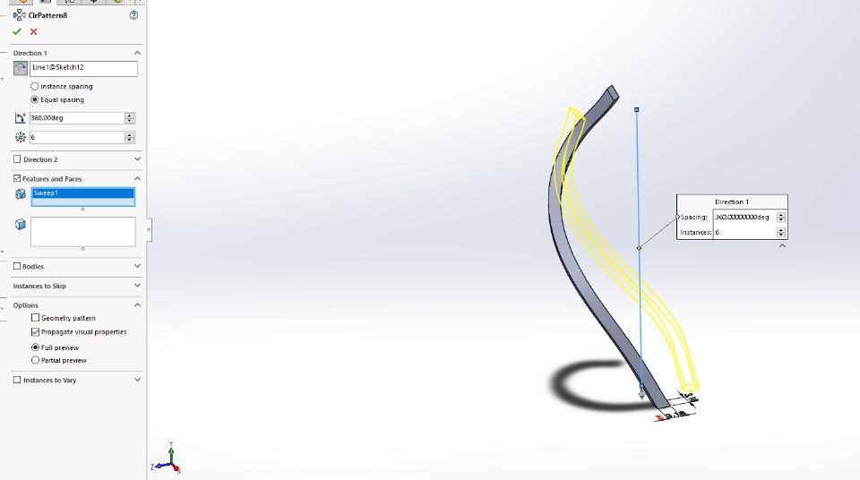

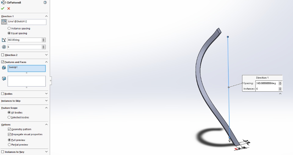

6) I thought I should be able to just use circular pattern but it will only ever show 1 instance
If I accept, I get only 1 instance but a different instance
I read about using geometry pattern but that still wasn't working

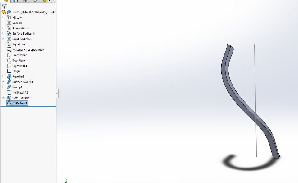

Then I read that it may be because i'm patterning a stand-alone body that isnt part of another feature so I added a base to pattern on
BUT NOW WHEN I REVOLVE PATTERN THIS HAPPENS
