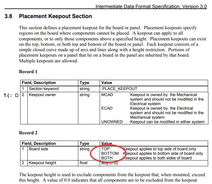

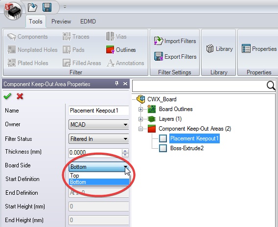

Trying to come up to speed with circuitworks 2018 with IDF 3.0; when defining the board side for a placement keep out, my only options are "top" and "bottom" even though the IDF 3.0 specification allows for the additional option of "both", can someone confirm if circuitworks supports the "both" option or not?
