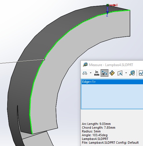

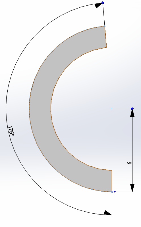

- Created a sheet metal part from a sketch which consists of a 175 deg arc, i.e. not a complete half circle. Note that the sketch defines the outer diameter.

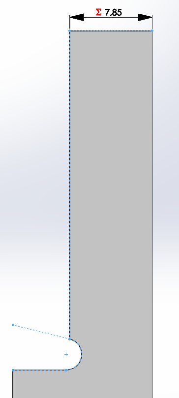

- Unfolded the part to add a cutout which I wanted to dimension when the part is in an unfolded state.
- Folded the part and realized that the measurement isn't applied as I expected as the distance I have set is used as shear chord line instead of arc length.
Is this expected behavior?
