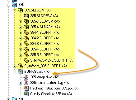

I am trying to add a file (say xxx.doc) to the vault."xxx.doc" is a generic workmanship document that applies to 2different projects. I can "check in from disk" into the firstproject - no problem.
What I cannot do is to get "xxx.doc" also shown in the secondproject. I am not allowed to "check in from vault" into the secondproject. I also cannot go to the 2nd project and attach the file tothat project.
A workaround is to create a dummy file (say "project2 files.doc")and "check in from disk" to project 2. I can now attach xxx.doc toit. This leaves an extra file in the vault tree functioning simplyas a placeholder. If "add attachment" would work on a project inthe same way it works on other files the problem would be solved.
Am I missing something?SolidworksWorkgroup Pdm
