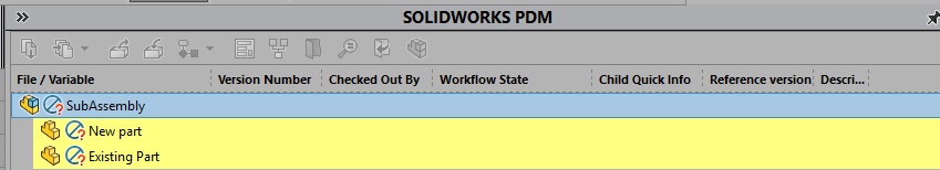

check in icon is grey out
I already login (PDM standard)
Why the check-in icon on my SW is grey out? Is there anything I need to do to make it enable ?
Answer from Craig:
The assembly isn't saved in the vault yet.  (the blue circle with the line through it)
Save it in the vault first, then you can check it in.
