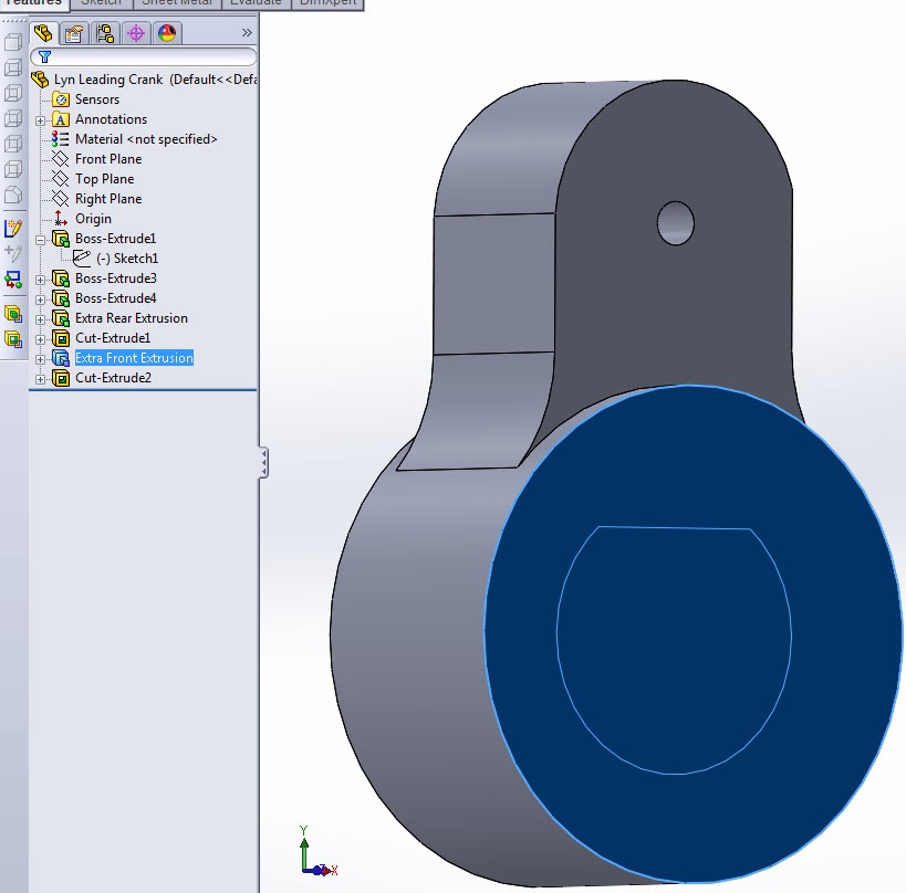

I have just altered this drawing of a locomotives flycrank to add the highlighted forward extrusion from the previously flat front face.
This new extrusion has filled over the axle hole with a solid.
When I did the same to the rear i fixed it by dragging the extrude up the feature tree so it was before the cut.
I have tried this for the front case but SW wont let me drag it up above the cut.
I cannot see why?
Can someone point me in the right direction.  I could fix it by redrawing the thing to ge the new solid shape before then adding the cuts but I would like to understand what is controlling the sort to prevent it in this case from the point of view of learning about stuff
I have attached the file if the knowledgeble ones want to look at it
