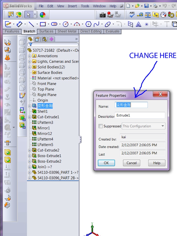

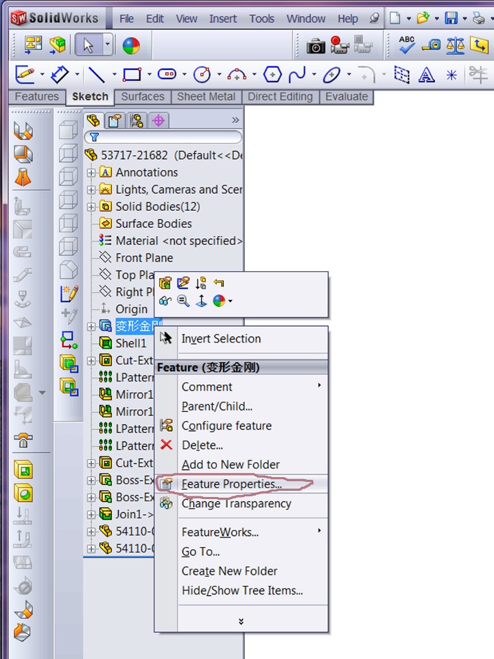

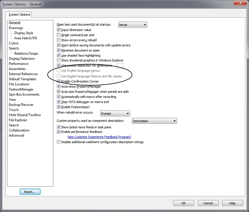

Ok really silly issue - but ive got a drawing from China I want to modify, but the design tree is all in chineese - tried all sorts but cant seem to change it............ heeeeeelp! haha!

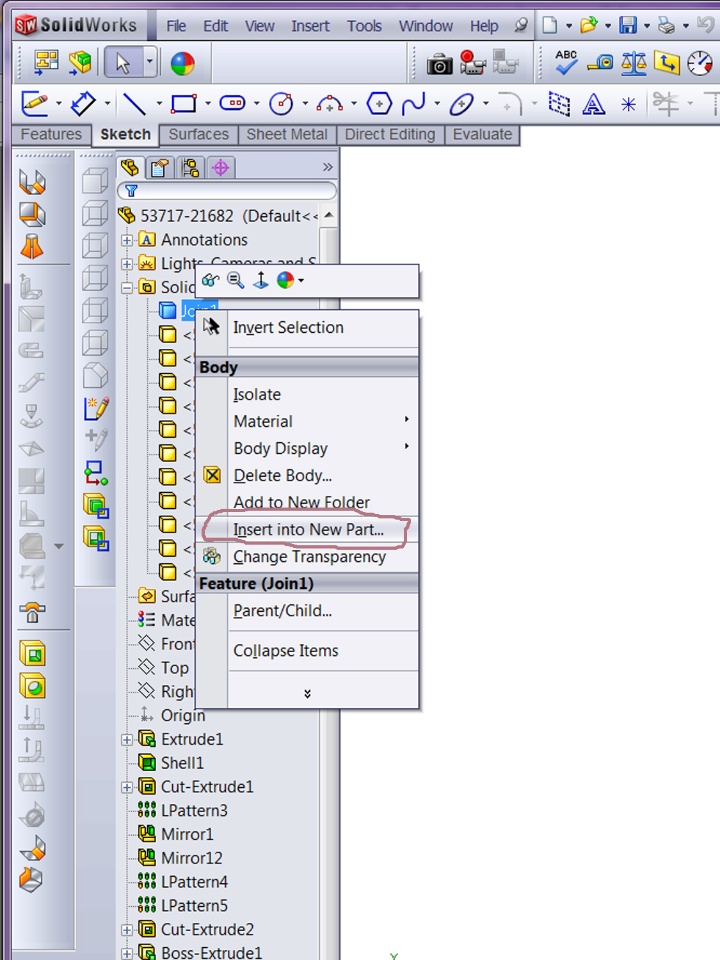

Also, is there an "easy" way of copying out a part of this "part" and save it as a seperate part? Then to be pulled together as an assembley?
Ok - so that doesnt make much sense................. hard to explain so imagine a cars been made as a single "part", rather than the body in one part and wheels in another part, and then all pulled into an assemley. I want to take off a wheel as a "part" so I can have the car body as one part and the wheel as another.
