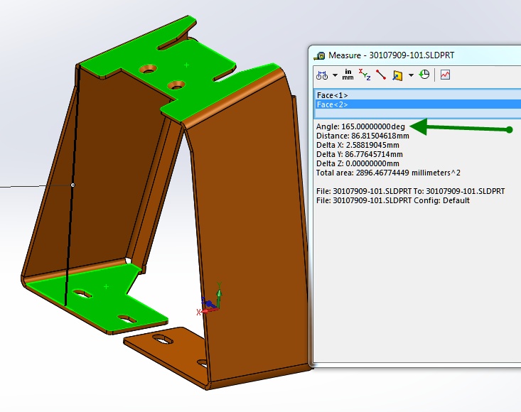

I was able to create this part by extruding and then converting to Sheet Metal but when I start the part from the SM option (no convert to SM) I cannot get the top angle to be exact. It is coming in about .5 degrees off. The angle should be 15 degrees from the top surface to be Base and I'm getting 15.5 when I made the 15 degree cut and add the top flange.
