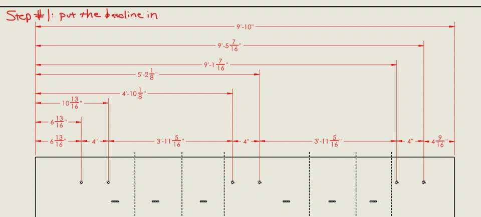

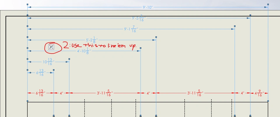

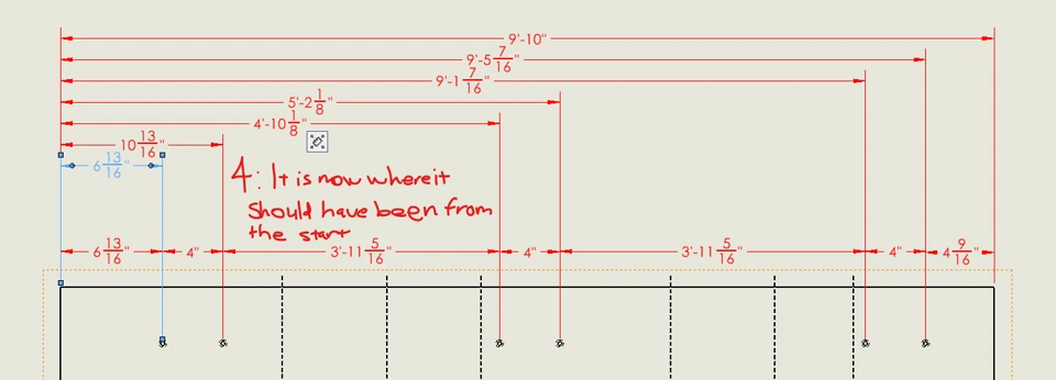

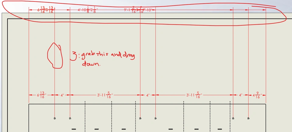

and on baseline: they always are way too spread out.
the workaround: put the baselines in, use the floaty menu to align them, then drag the smallest baseline in and it will put them spaced the way they were supposed to be in the first place.
see screenshots:
