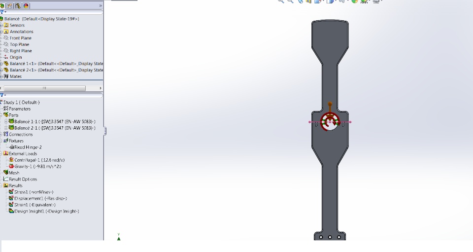

Hi,
This model is just a first approximation...
I trying to simulate an centrifugal force. I applied the centrifugal force in the axe which the part will rotate and gravity.
I'm doing this in an assembly.

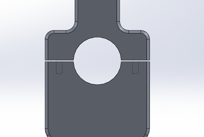

For the fixtures I used the fixed hinge in both faces but that makes the faces where are supposed to be bolts to touch which is not correct. What can I do to make the faces normal to the bolts not move relatively to each other?
Altough it will be the friction with the axe creating the reaction, so both parts remain in the same position relatively to each other.
Thanks,
Manuel Costa
