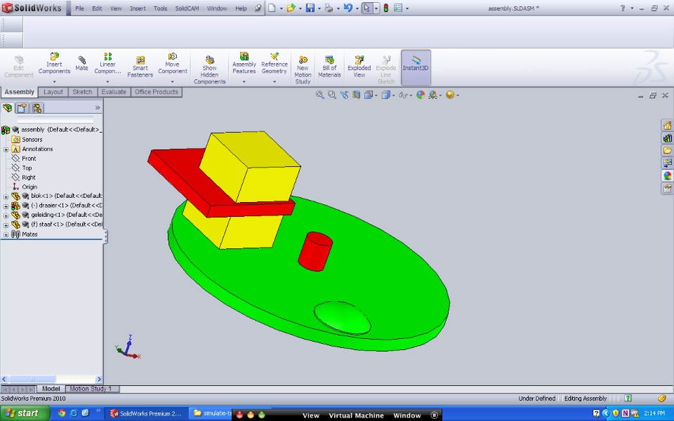

Cannot properly mate assembly
RED: FIXED
YELLOW: follower (moves up and down)
GREEN: turns around, with a knob.
I want the yellow block follows the green surface while rotating, so it will stay during +-350° at his position but when it passes the knob the yellow block has to move upward. I tried coincident mate and cam mate but both fail to do what I want.
Can anybody help?
