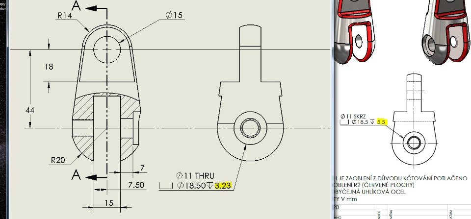

I'm trying to dimension the model mania challenge from 2016, and I think I have it built correctly. There is one dimension that I can't match to the drawing (see pic) . I am assuming that it only accounts for what it physically cut. See pic and/or file.
