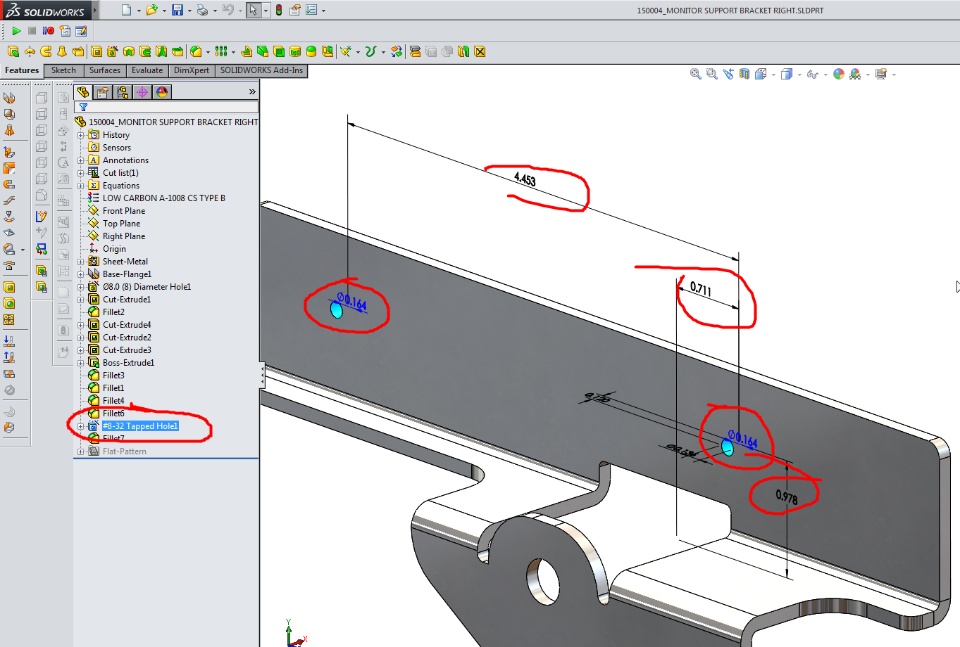

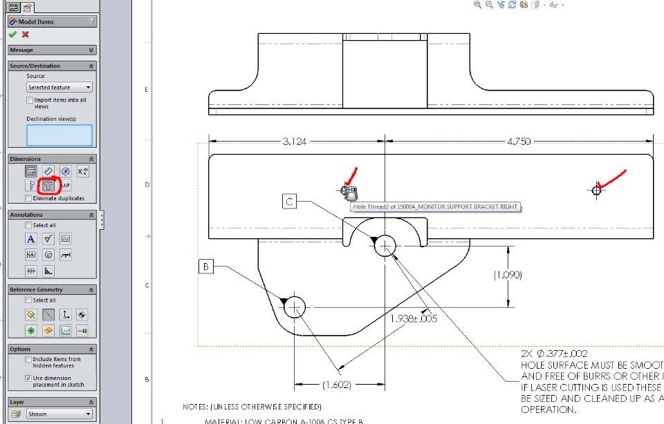

I cannot get hole locations or call-outs to appear in my drawings when I use the hole wizard. Files are attached. Can anyone help???
For example I used the hole wizard to create a couple of 8-32 tapped holes on the following part.
I'm hoping to get the drawing to automatically display the 8-32 tapped hole callout as well as the hole locations.
