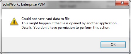

Since upgrading the server to 2013 SP2.0, after creating a file in the vault and before checking it in for the first time, users cannot edit the file card data.  Here are my steps:
  1. Create a new model in SolidWorks.
  2. Save it to the vault (don't check it in).
  3. In the explorer view, select the model.
  4. Edit a value in the file card.
  5. Click the "Save" button.
  6. Notice a message that says, "Could not save card data to file..."
I checked in a 2012 vault, and it doesn't have this problem.  Has anyone else experienced this problem in 2013?  If so, is there a fix?
