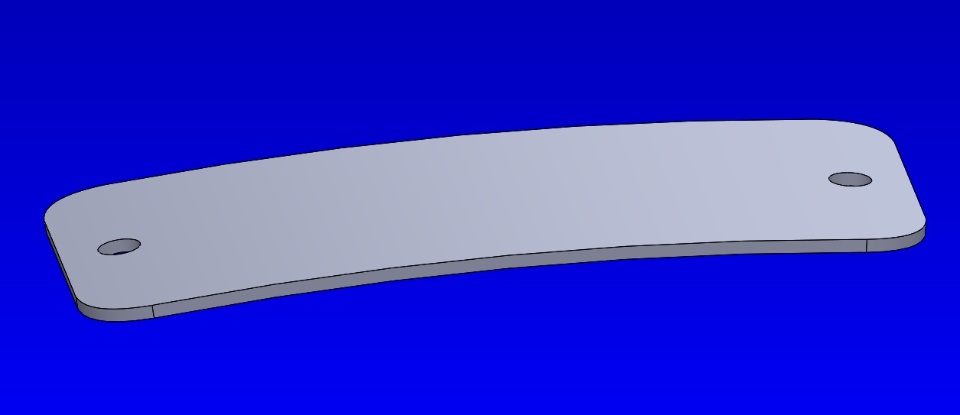

PART AFTER FOLD (WITH ETCHING SURPRESSED)

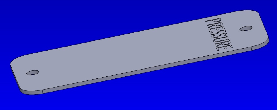

PART WITH ETCHING (FOLD FAILED - STILL IN UNFOLDED STATE)
