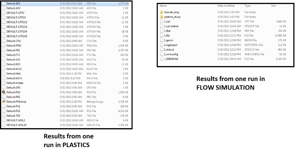

When you run a Flow study, you have folders, subfolders and something like 10 files that remain for results after you close SolidWorks (see attachment)
When you run a Plastics study, you have over 20 files that remain for results after you close SolidWorks (see attachment)
Talk about a file management nightmare!
