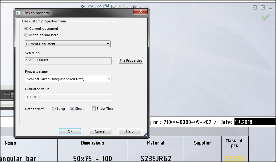

Hello,
I want to have a link to the short verison of SW-LastSavedDate in the upper row of the BOM.

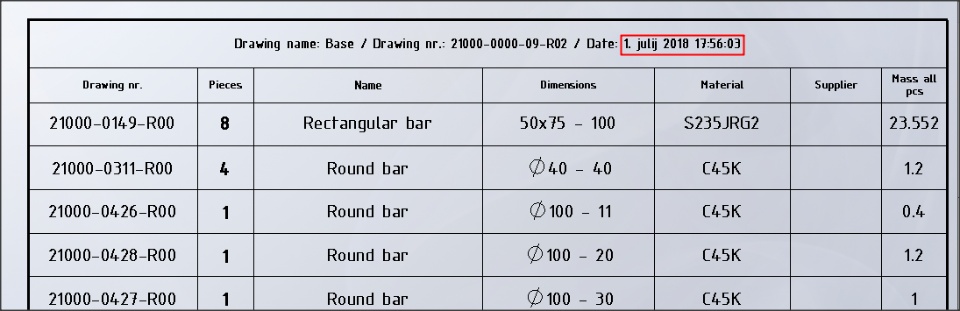

When I link to property I choose SW-LastSavedDate and then set for short format with no time. The datum looks fine at first, but then when I close the "Link to property" window it jumps to Long format with time. I have the same link on the sheet format and there it works just fine.
Is anyone experiencing the same problem? I am using SW 2016.
