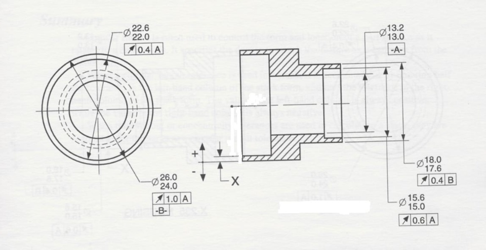

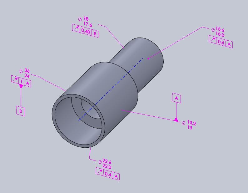

I can't measure the min distance (X) between the hole and cylinder as seen in the following two pics attached.
When I select the size dimension: The dimXpert assigns a cylinder instead of a simple hole to the following two hole dimensions.
Holes with dimensions 22-22.6 & 15-15.6
