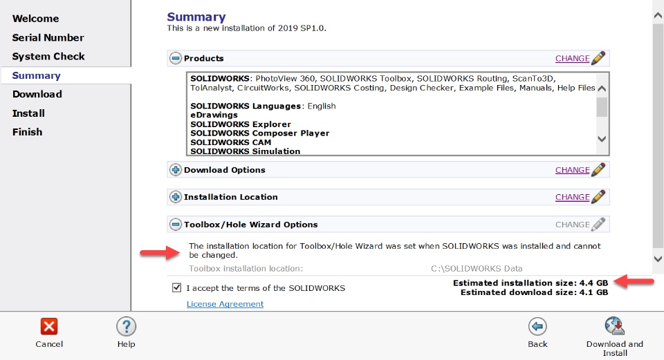

The problems start at the 'Summary' step of the installer. Here, the 'Toolbox/Hole Wizard Options' are greyed out and cannot be changed. The dialog displays: "The installation location for Toolbox/Hole Wizard was set when SOLIDWORKS was installed and cannot be changed. Toolbox installation location: C:\\SOLIDWORKS Data". I have no idea where this configuration is saved on my system. I deleted the respective folder, but that doesn't change anything.
Also, the installation size of 4.4 GB is strangely low for a complete SOLIDWORKS Premium installation.

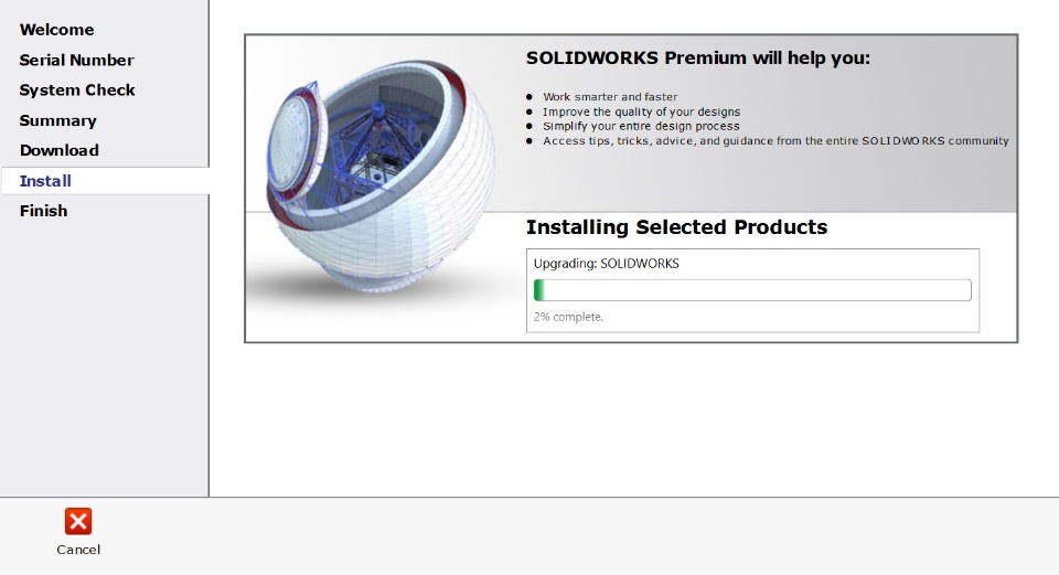

Next up is the actual installation. As you can see below, the installer is trying to perform an upgrade, rather than a fresh installation. I have no clue what traces of my old SOLIDWORKS installation the installer has decided to upgrade.

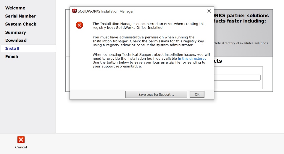

After some progress, around the 10% mark, a first error message will be thrown. "The Installation Manager encountered an error when creating this registry key: SolidWorks Office Installed." I am not sure if this is related to the overall failing of the installation though.

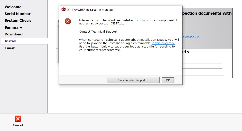

Then at around 16% progress, a second error message is shown. "Internal error: The Windows Installer for this product component did not run as expected: INSTALL.".

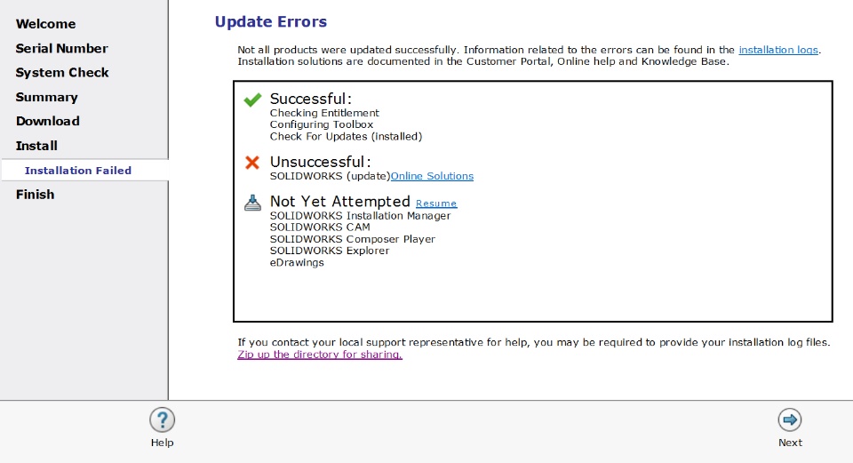

Hereafter, the installation fails and is cancelled.
