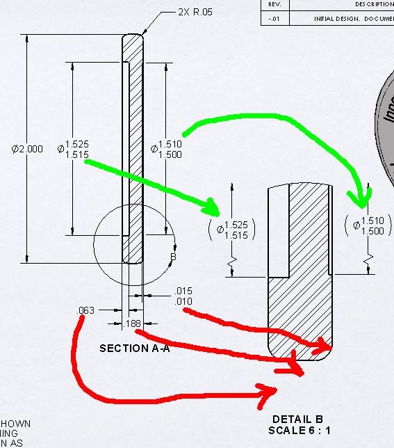

I have a Section View (A-A) of a simple part.
I dimensioned the Section View and then I created a Detail View (B) of that Section View to show things a little more clearly. To include all the dimensions in that Section View I used the Insert Model Items function. I did this because that way the tolerances came over from the Model as they should.
I was able to hold down Ctrl and drag a copy of the two diameter dimensions from the Section View to the Detail View, as shown by the Green lines in my attachment. They even came over foreshortened and I was very pleased.
I tried to do the same thing (hold Ctrl and drag) to the three linear dimensions. No luck. When I release the mouse button, the original dimension selected in the Section View stays selected. These dimensions are indicated with angry red lines!
I tried Inserting Model Items in the Detail View of the Section View instead, no luck trying that either.
I know I can work around by manually inserting a reference dimension but then I'd need to set up the tolerance manually. This opens things up for mistakes and should not be necessary. I also know that tolerances are not appropriate for reference dimensions but that is not it since not all the dimensions in question have specific tolerances.
