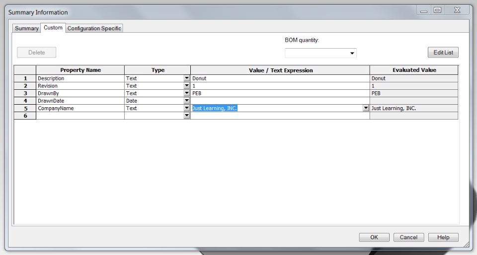

Here's a screenshot of the custom properties table in the part:

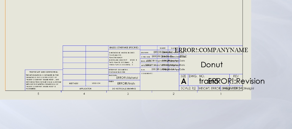

and here's a screenshot of the drawing, in edit sheet format, w/ view annotation links selected:

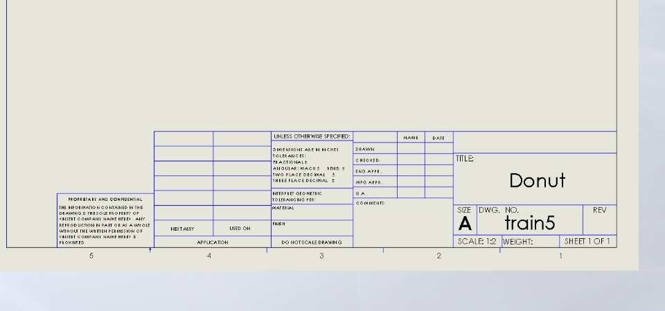

and finally, a screenshot of the drawing, in edit sheet format, w/ view annotation link errors selected, but annotation links not selected:
As you can see, custop properties for the "CompanyName", "DrawnBy", and "Revision" are all in the table, but do not show up in the drawing.  However, the link errors do.  When I hover, these show up as \$PRP, so I'm assuming they are referencing the part and not the sheet.  I have also tried selecting various drawing views instead of the "Default" on the sheet properties tab.
