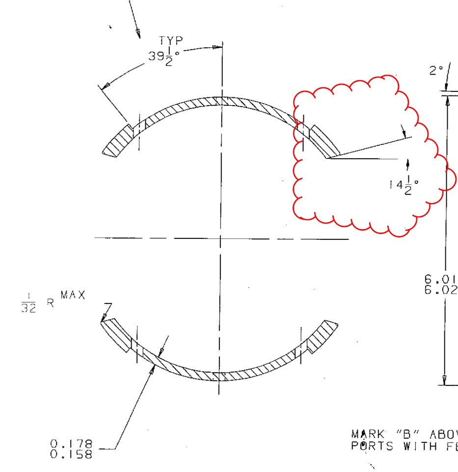

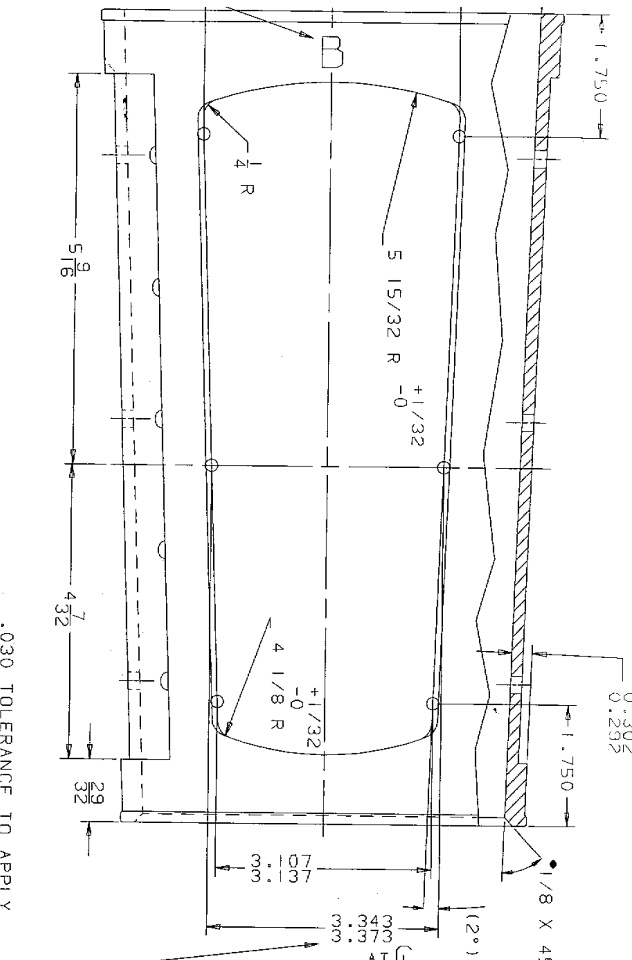

Attached is a model and a couple pdf details of the last thing I need to do.
The window openings need to be angled from the inner wall to the outer wall @ 14.5 degrees.
If you orient at left or right views, that's the openings I need to flare out. Same view as "window flare help outside.pdf", but only on the sides of the opening, not top & bottom.
I am stumped, not sure where I begin to do this...
