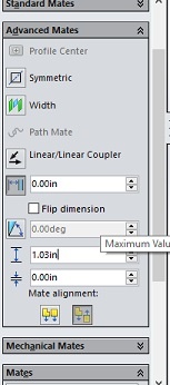

Hi, I'm using Solidworks 2015.  I have an assignment involving a clamp assembly with four configurations.  I'm using a limit mate to constrain the arm of the clamp.
The limit values aren't right for the other four configurations since 2, 3, and 4 get larger respectively.  I want to add configurations to the values of the limit mate instead of adding a mate for each configuration, but I don't see where the option is to do that.
Should't there be a little configuration icon by the value in the box?
