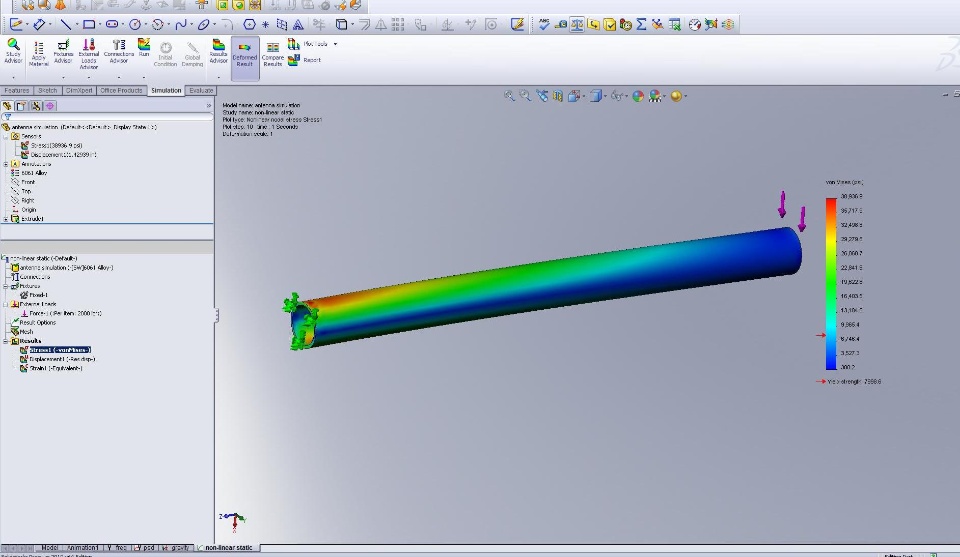

I would like to be able to predict when a part will fail. I define a failure for this case as a complete fracture of the part which allows the component to separate into two pieces. I have looked at some of the non-linear static examples and set up a simple problem but don't really see how to get there from here.
If I model a cylindrical hollow aluminum tube that is 48" long x 4" dia. X .25" thick I can restrain one end and apply a load to the other end. I can also depict this problem on paper and solve for the bending stress and displacement which matches the SolidWorks solution very closely. That's the good news. How do I use the simulation to predict when the part will actually fracture? Can I do that? Obviously stress in excess of the tensile strength is a problem but I would like to quantify what value is required to fail the part.
When i vary loads on the example described above I seem to continue to get linear results even as the stress in the part goes well above the tensile strength. Shouldn't the displacement and stress be non-linear by definition?
I picture is attached. Any insight would be appreciated.

Thank you for your responses. I did a poor job of communicating my questions. Let me provide some more information and answer some of your questions to me.
1. The material is ductile, stated as aluminum in the first post.
2. I understand that the code will not depict a "fracture" lets forget I said that
3. There will be no testing of this hardware
4. Yes, this is a simple case. It is academic. The reason for the simple case is so I can generate hand calculations. My intent is to understand how the software works. I do not intend to use a product unless I understand how it works.

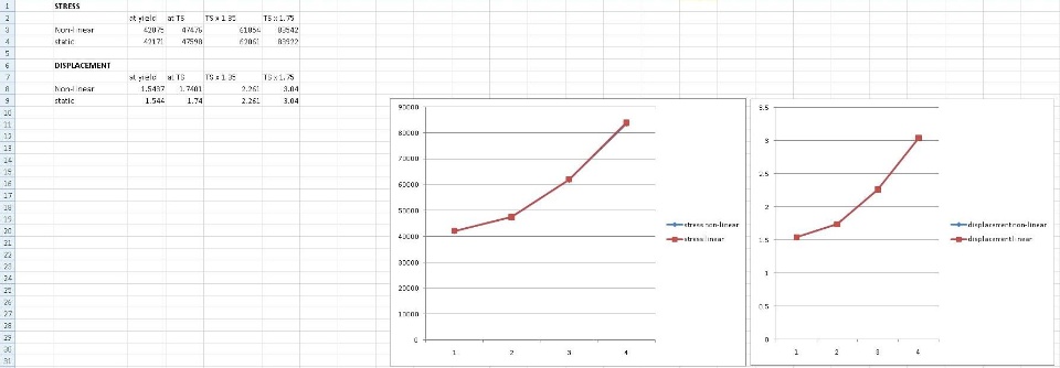

O.K. back to some specific questions and results. My expectation was that I would get non-linear results when running a non-linear analysis. That doesn't seem to be the case. I have run analyses in the static and non-linear tool and get virtually the same results. The material is aluminum 6061-T6 at the dimensions stated in the first post. I have run the following analyses in both linear and non-linear and gotten the same results. I ran a case with a load close to yield strength, a case at tensile strength, a case at 1.35 times tensile strength and a case at 1.75 times tensile strength. I get the same displacements and stresses. My expectation was that the results say for displacement would increase in the non-linear study above the tensile strength and "track" the stress/strain curve.
Again any comments are appreciated. Attached are two graphs showing stress and displacement for the two analyses. It's difficult to see there are two sets of data as they are right on top of one another.

SF 2010-05-13
I think I figured out what was going on. It appears that one can select a non-linear static study and then execute the study without selecting non-linear material properties which is what I did. Creating a custom material seems to do the trick.
