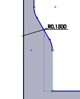

Now I'm trying to create a family of parts (tube flaring inserts) that step up in size and I was hoping to use configurations to do it but it's not working. I have a revolved sketch and when I go to the second configuration and drag the sketched line to the new dia, it changes both configurations.
So my question is, do configurations only work on new features or can I somehow change things like the dia using the existing sketch?
