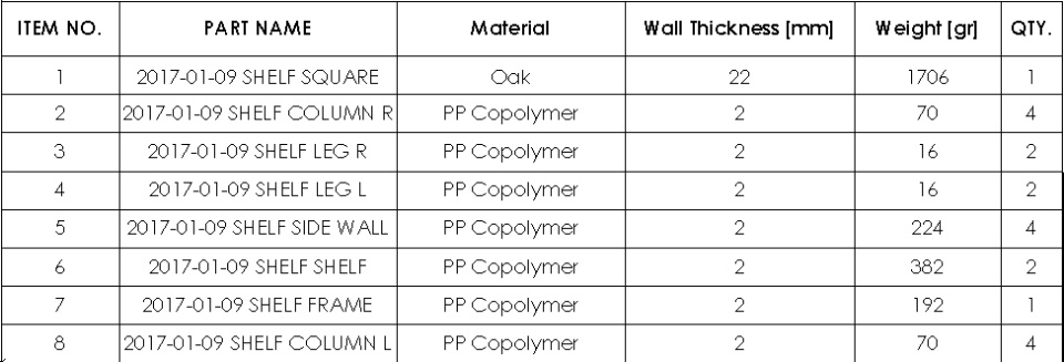

First, let me say I know how to define the "Total" definition in a cell (in order to sum all the values in the specific column).
my sequence of actions is this (question at the bottom):
  1. I add the "Total" definition to a cell in a BOM table. it evaluates the sum of the values of the specific column.
  2. I save the BOM as a template.
  3. When I open a drawing, add an assembly view, and then try to add the BOM using the same template I just saved,
        The row with the "Total" DOESN'T APPEAR.

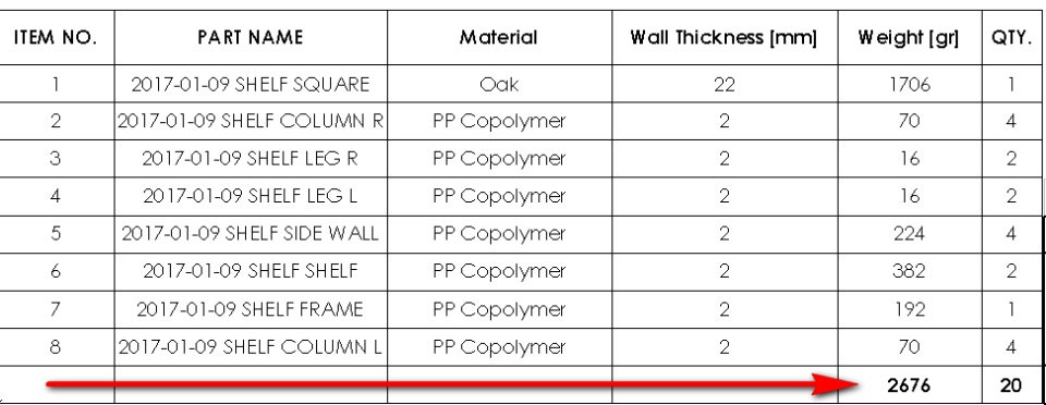

Does anyone know how can I save a table template that will INCLUDE the row with the "Total" Value (see attached picture)?
I'm using SW Premium 2014 SP5.0 64-bit.
