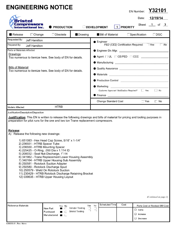

JH
JH 2015-01-21
Attached is a sample of what we do now. All manually signed off.
BM
BM 2015-01-21
Usually it  is okay to do multiple drawings on one EC.  It varies with the scope of the change, but they should be related somehow. We do from 1 (or 0) drawings, up to about 50 per EC (large is EC is generally for a new assembly).
Most EPDM systems use the Paste As Reference method for managing EC, but it is far from ideal - I'm sure there are ways to make it better (some get into API programming, etc).  We no longer use it, here is why:
*Paste as Ref will drag the child files thru when the parent is transitioned to a new state. But people don't tell you it doesn't work cleanly.  You have to manage checkboxes almost every time you use it.  It will check things you don't want and not check things you do.
*When you look at the Contains  (or Where Used) tab you often seen junk that doesn't make sense - child items of the things that are actually Pasted as Ref.  You cannot do anything from the Contains or Where Used tab anyway (only useful thing is browse to files in their folder).
Instead...
*We use a Search based system - so we put a consistent EC number on every file in the EC.  From the Search results you can run Dispatch scripts, Change State, and Check-in-out. Once the EC is on the appropriate files we don't have to worry about it - if you Change State and you get exactly what you expect. By default we don't search on All Versions - so we only get the stuff that is still part of the EC (when things are removed).
For adding things to the EC - the way we were doing things it took longer to use Paste as Ref than it does to add the EC number to the files.  (I use a Version Free variable to make it easy to add files to the EC).
