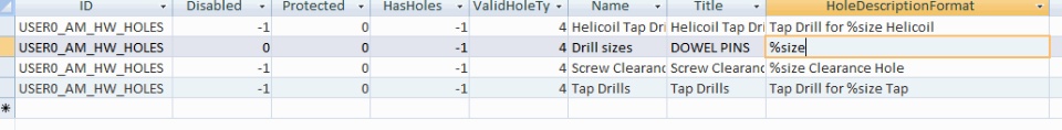

What I'm running into: We do generic callouts for slip and pressfits because of the wide range of materials. If I forget tomanually add this callout, I get a bad part.
Question is, can I modify my calloutformat.txt to link specificallyto these design library features so we all are pulling the sameannotation with these specific features?
For example, I now have a design feature for 8mm slip fit, now Iwant to have hole callout recognize it as such and add (slip fitfor agathon)...or (slip fit for dowel)
