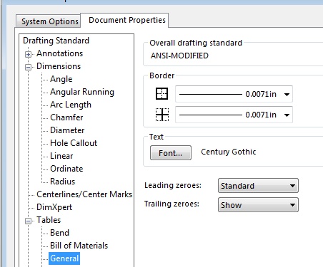

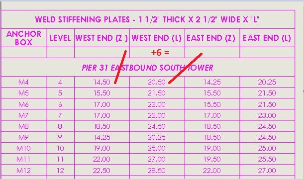

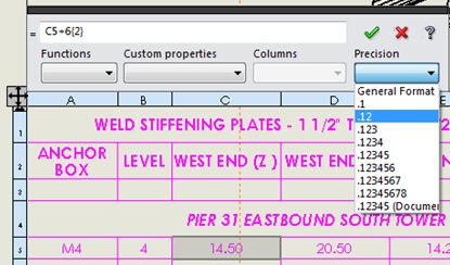

I created a general table on a drawing and would like to make a simple additional column next to an existing one.  When I make an equation for that column, the trailing zero is not appearing.  Since I like to be consistent, I had to manually key in the values on the new column since I cannot get the zero to appear.  See below for clarity.  All I need to do is add 6 to the value in the column to the left of it.  When I make the equation by selecting the given column, then keying in " +6 ", the number appears correctly in the new column but there is no zero (I want it to appear as 20.50 instead of 20.5).  I checked off the precision in the equation dialog box to two place decimal accuracy but it changes nothing (see second below snip).  Even tried changing the dimensions / table trailing zero to "show" in Options and this changes nothing.  Can this cell value precision not be changed?  I saw some posts on here from over 5 years ago concerning this and back then, it was considered a glitch I believe so I assumed it was fixed.  Thanks.
