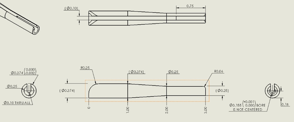

Can anyone help me with dimensioning this part?
I want to start out by saying that my experience is dimensioning parts is very limited. I am just now getting more involved in creating my own mechanical drawings. I know that there is a few "industry standards" that certain prints follow, but I am more concerned on just dimension the internal features that I have on this part. Only key is to keep it simple, which is something I'm struggling on. I want to avoid adding any more views unless I have to, e.g. section view.
With that, what I am struggling on, are the multiple tapers on the outer and inner diameter. I also have a bore at the end of the part.
This part is not the actual part, but a good imitation of it. Any help is much appreciated.
