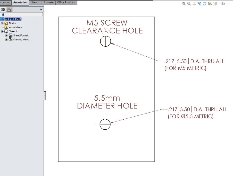

Calloutformat.txt file & the proper drawing callout for screw holes vs plain?
How do I get the proper drawing callout for the 5.5mm holes shown?

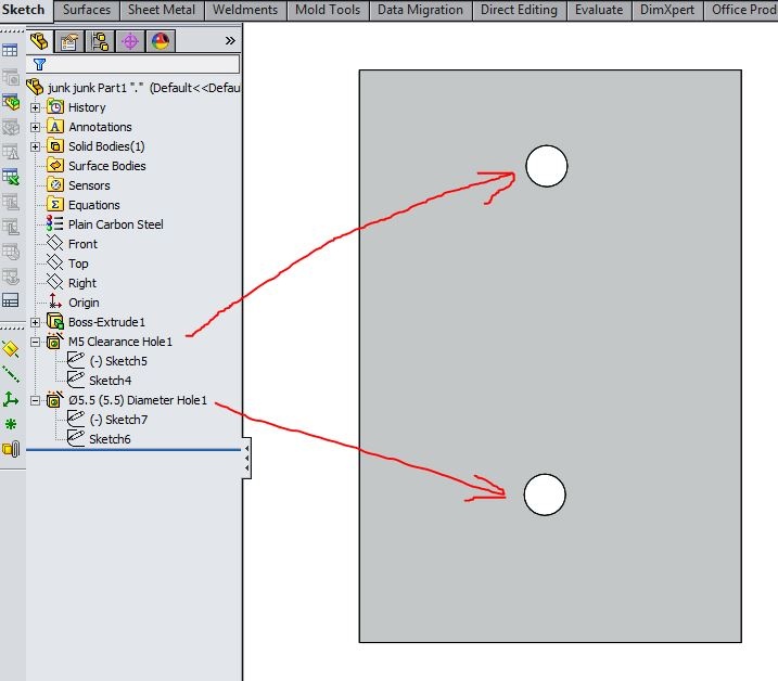

When I place a screw clearance hole in the model why can I not get it
to use   for only the screw clearance hole.
for a plain hole I do not want the    call out

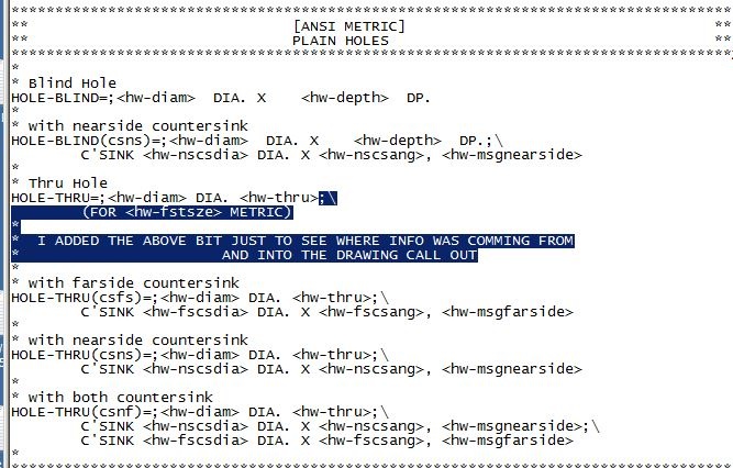

BUT where is there in the calloutformat.txt file a place for the
*        screw clearance         *
cannot find it in my call out format txt file
see attached files
