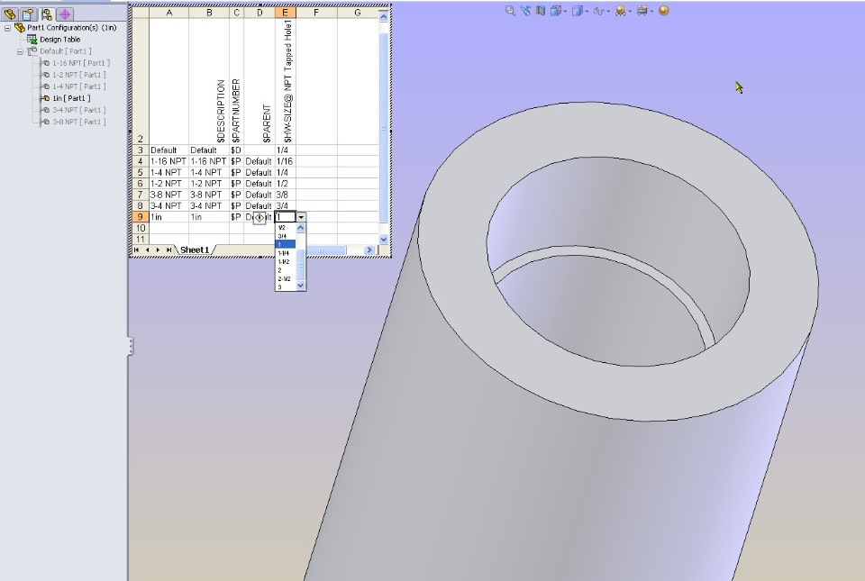

I'm making a part with a pipe thread at the end. I have adesign table and need to put a different size thread on each part.I'm hitting a blank when it comes to figuring out how to put thisin the design table. I know I can make a feature with each size andsuppress it in the other configurations but it seems like thereshould be an easy way to call out which size I want in the table.
