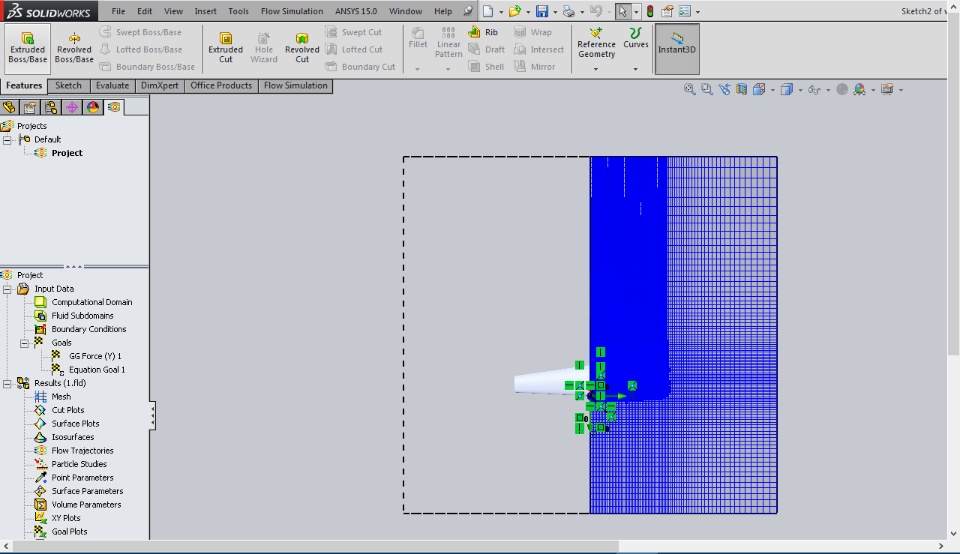

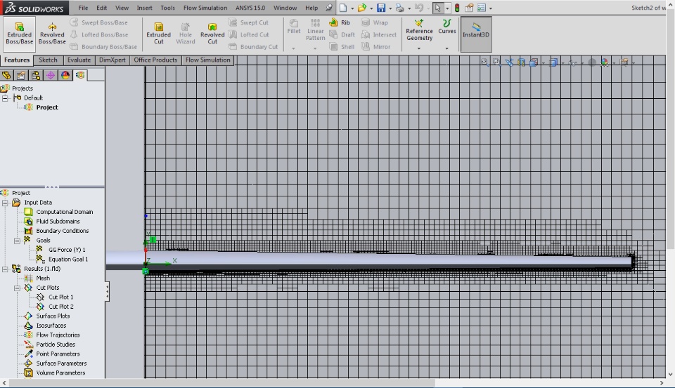

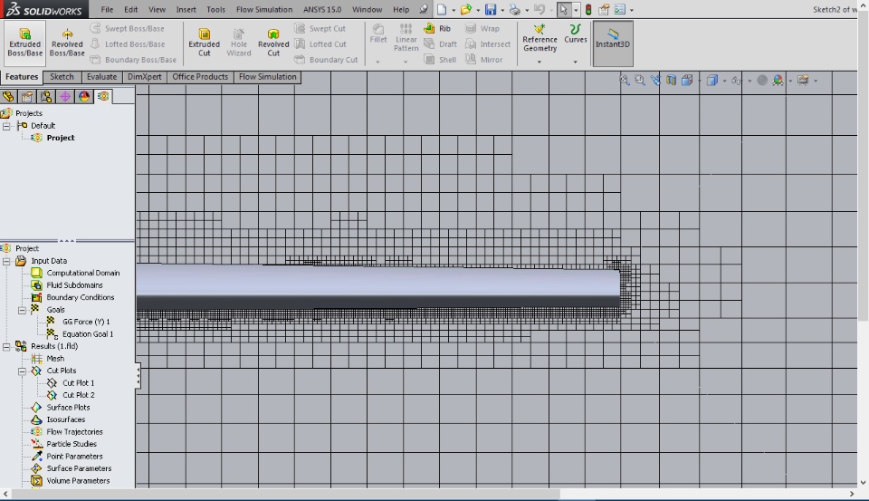

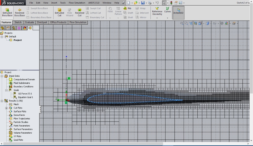

The Mesh was created using a level 1 initial mesh with a level 5 refine set to refine every 1 travel starting with the 2nd full travel. The resulting mesh is pictured below.

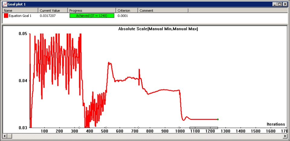

The simulation converged after after 21 hours with a mesh of 5.75 million fluid cells + 320,000 partial cells. The converged value for CL is 0.317, off from the theoretical value by about 6%.
I am okay with the accuracy, but would like to know if there is a way that I could set the problem up differently to shorten the calculation time without bringing down the accuracy of the simulation.
