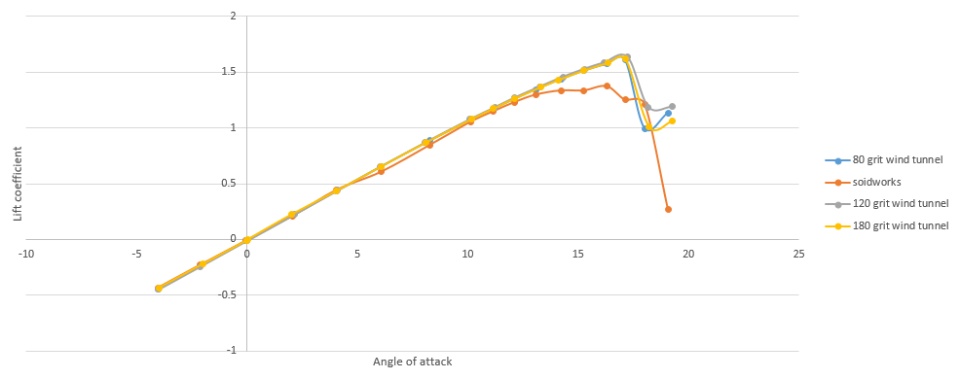

I am currently doing a thesis on the design of a rear wing for a formula student car. I am currently trying to validate my results for a 2D flow simulation of a NACA 0012 profile using data provided on the NASA website http://turbmodels.larc.nasa.gov/NACA0012_validation/CLCD_Ladson_expdata.dat
I have good correlation until about 13 degrees where it seems to tail off. You can see a rough graph comparing the wind tunnel data to my solidworks results below.

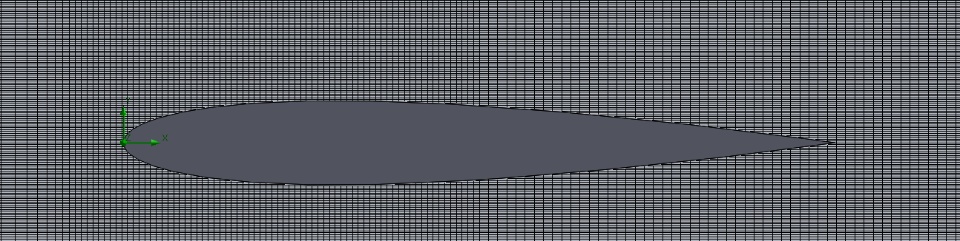

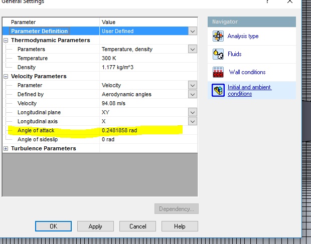

In order to simulate the angle of attack I have the airfoil sitting parallel with the meshline, and I select the angle of attack in the general settings.
Now to calculate the lift coefficient, I insert a global goal for the Normal Force (Y), and then insert an equation goal to calculate the lift coefficient. However, one thing I recently became aware of is that the Normal Force (Y) is always perpendicular to the airfoil, rather than perpendicular to the flow, which is what I want to know.
Is there a way that I can calculate the lift coefficient for the wing, perpendicular to the flow rather than perpendicular to the airfoil?
