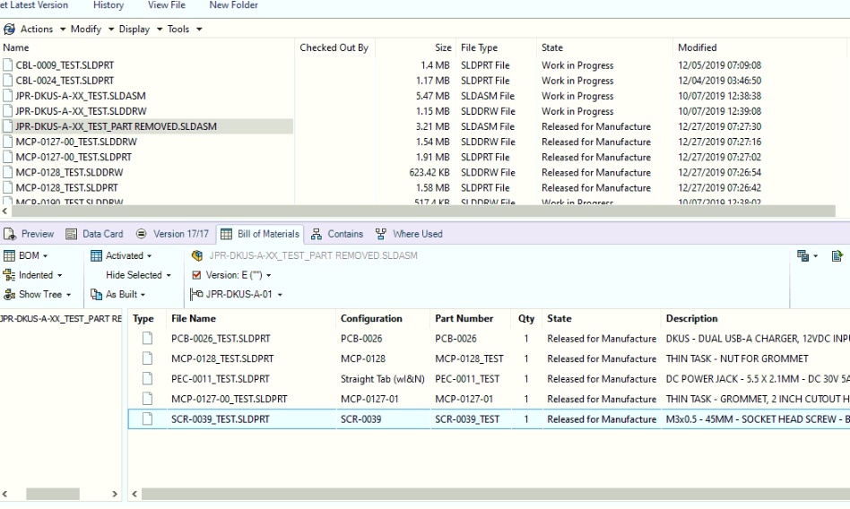

Actually i created one addin where whenever file state is change i want to fetch 'Data card' tab information. in following figure 1. (ex. its JPR-DKUS-A-01 ...02 etc..) -> But strange this is i am not getting it but actually what i get is BOM's last row's product information (SCR-0039) (see figure 2) ..when i do state change on other file i am getting proper data card information who don't have BOM. don't know why this is happening.
Figure :1
Figure:2
