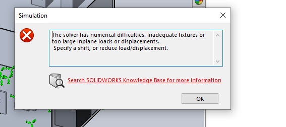

Hello everyone,
I'm trying to prepare several Frequency simulation studies via solidworks api to later run a bunch of them via c# ... and some how I want to Dismiss Errors (it appears less than 10 times in 1000 runs also I can handle it with changing mesh size or solver type to FFEPlus or using soft spring and ... but eventually on user demands it may appears) Automatically during the simulation process because I do this study for thousands assembly and it's important for me the program resume the works in loop even be making loss some results
This error + one warning dialog that tell "Simulation failed" appeared some times and I want to dismiss Anyway ...
