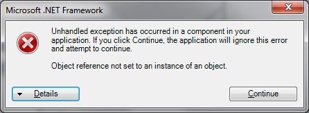

Hello,
I am have been able to add a task pane successfully into SolidWorks, however the windows form I call on with the taskpane, which has been created by a user control, appears but when the button is selected the code found in the Form5 button will not run and displays this error.  Does anyone know or have a solution to this error?
Thank you for your time and efforts in this matter!!!!!!!!!!

        Form5 form5_BP = new Form5();
        public const string SWTASKPANE_PROGID = "RaceWork.SWTaskPane_SwAddin";
        public SWTaskpaneHost()
            InitializeComponent();
        private void button1_Click(object sender, EventArgs e)
            form5_BP.Show();

    public partial class Form5 : Form
        SldWorks.SldWorks swApp;
        ModelDoc2 swModel;
        public Form5()
            ModelDoc2 swModel = default(ModelDoc2);
            ModelDocExtension swModelDocExt = default(ModelDocExtension);
            bool status = false;
            double F = 18;
            swModel = (ModelDoc2)swApp.ActiveDoc;
            swModelDocExt = (ModelDocExtension)swModel.Extension;
            //F
            status = swModelDocExt.SelectByID2("3DSketch3", "SKETCH", 0, 0, 0, true, 0, null, 0);
            status = swModelDocExt.SelectByID2("D2@3DSketch3", "DIMENSION", 0, 0, 0, true, 0, null, 0);
            Dimension swDimension1 = default(Dimension);
            swDimension1 = (Dimension)swModel.Parameter("D2@3DSketch3");
            swDimension1.SystemValue = F * 0.0254;
            swModel.ClearSelection2(true);
            status = swModel.EditRebuild3();
