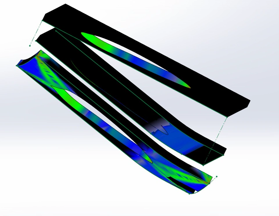

Hi everyone, At work I often need to model bent objects — I usually design eyeglass frames. To do this, I always start from a flat shape and then create a curved (meniscus) surface, because that’s how it’s actually made in real life.
Sometimes I use the Flex feature, but when that doesn’t give the desired result, I switch to the Deform command.

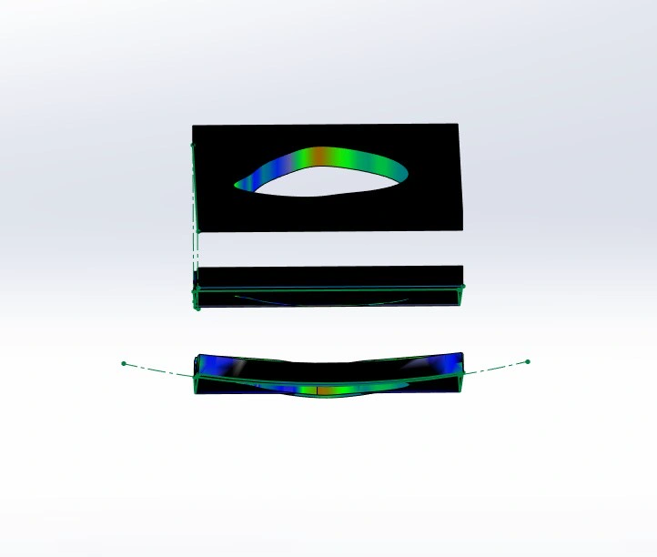

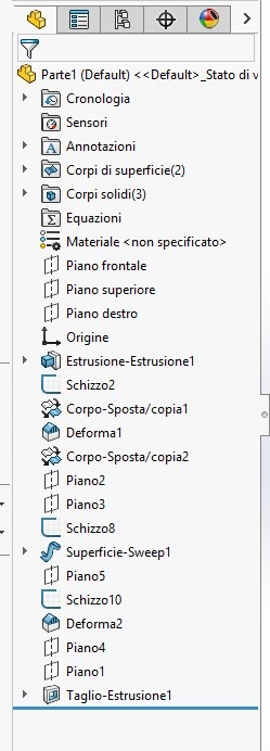

Here’s the issue: if I apply Deform twice — first along the X axis, then along the Y — the first deformation works fine, but the second one produces an incorrect result. I’ve tried using 1, 2, 3, and even 4 curves to reposition during the second deformation, but in every case, the solid ends up wrong.
In the second image I uploaded, you can see three solids: •    the first one at the top is flat, •    the second one in the middle is correctly bent along the X axis, •    the third one at the bottom is supposed to be bent along both X and Y axes, but it doesn’t look right.
Is there a better or more reliable way to bend a solid in both directions? Any advice or suggestions would be greatly appreciated!
