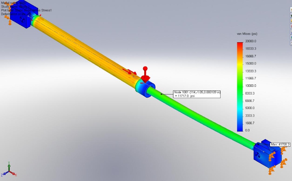

I have a quiestion for you experts out there. I am currentlyworking on a rather large hydralic cylinder, the engineer here hasa spreadsheet for calculating buckling using Euler's formula,mostly concerned with rod dia., so in the spreadsheet we are usingthe extended length of the cylinder & the rod diameter for theentire length of the extended cyl. This 6" bore cyl operates at4500 PSI has an extended length of 201.25". So the spreadsheet sayswe need a 5.16" rod dia to achieve a 2:1 factor of safety. I ranthe cylinder with a 4.500" dia rod in simulation, & then ran arod 5.160 dia. of the extended length to compare against what thespreadsheet was telling us.
In the cylinder I restrained both end clevis's and applied 4500 PSIload to the inside cyl wall & the piston face. The pins werefree to rotate in the clevis bores. & gravity applied, withcylinder in a horizontal position. I was careful to have the wearring supports in the proper locations on the piston & gland tosimulate the actual support.

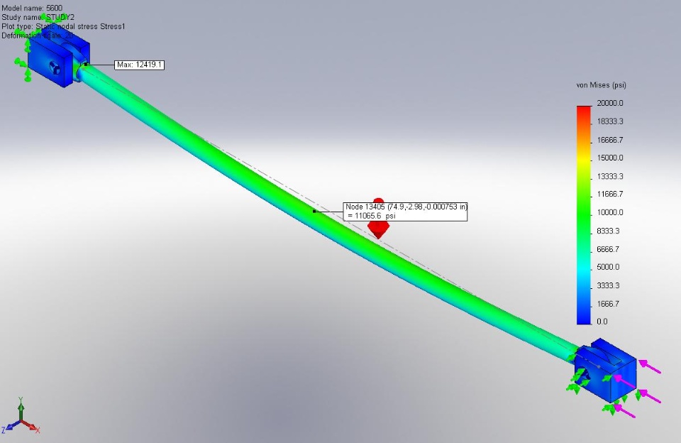

In the rod simulation I fixed one clevis, applied a load of 127,235lbs to the other clevis, again gravity applied & pins able torotate in the clevis bores. I have attached JPG's of thesimulations, cyinder & 5.160" rod.
Now the question: Is the hydraulic cylinder bucking in simulationreliable enough to say, yes a 4.500" cylinder rod adequate? Orshoud I continue to rely on Eulers formula for column buckling onhydralic cylinders. My though is that the way we are calculatingwith the spreadsheet isn't considering the added strength thecylinder tube adds for buckling considerations.
I ran the rod simulation with a 4.500" dia on the rod also &stresses were near 40,000 psi., so a 4.500 column the ext lengthdoesn't cut it, but a 5.160" does, and the cyl simulation with a4.500" rod is very close to the stresses in the 5.160" rod.

These cylinders are for a large knucle boom type loader, theywill cycle from vertical to horizontal, so added gravity & ransimulation with the cylinder horizontal to give side load asgravity would do. The deflection shown is at a scale of 20, you cansee the center bowing down slightly. I believe the formula we useon our spreadsheet is a common method of calculating columnbuckling, I could be wrong but, I don't think it takes gravity intoconsideration, or any other external side loads, but maybe a thereis some consideration given in the factor of saftey.

Buckling is far more complicated and subtle than most peoplerealize. The Euler computation implicitly assumes that the stuctureis undeformed - the loads do not affect the stiffness and it isessentially a part or bonded assembly. In a FEA simulation you have3 kinds of buckling: linear, non-linear and post buckling. If youwant to cut it close you need post buckling - that is you do an NLananlysis with RIKS (arc length in cosmos speak) or the Crissfieldcontrol scheme to have the numerics hang together so that thesolution can proceed through the snap thru and see where itactually buckled. In cosmos contact is not supported with thiscontrol scheme. I have been to within less than 1% as compared toexperimental. Then you have Non-linear buckling: you do a staticanalysis of the loads to prestress/deform the model and then you doan eigenvalue extraction on the resulting stiffness matrix to getthe buckling estimate of the deformed and loaded structure. Ibelieve that Cosmos Professional is capable of this type. You cantell if the problem looks like it is being solved twice. This is acloser estimate but can still result in significant uncertaintiesdepending on how close you are to a geometric induced instability -ie load eccentricity induces the buckling as opposed straightcompression. In linear buckling none of the loads are used otherthan to give you the buckling load factor. In ASME pressure vesselsa factor of 4 is used on linear buckling just to give someperspective to the potential uncertainties. For the case at handwhere load eccentricities seem difficult to come by due to thepinned ends you need to apply your engineering judgement to sortout how close you can go. I tend to devise expereiments that I canrun either numerically of experimentally to bound my uncertainties.Hope that helps.

Thanks Bill, a lot to consider there, sounds like you haveconsiderable experience & appreciate your input, I believe weare going with the bigger shaft diameter, maybe more than we reallyneed in this situation, but better to err on the safe side Iguess.
